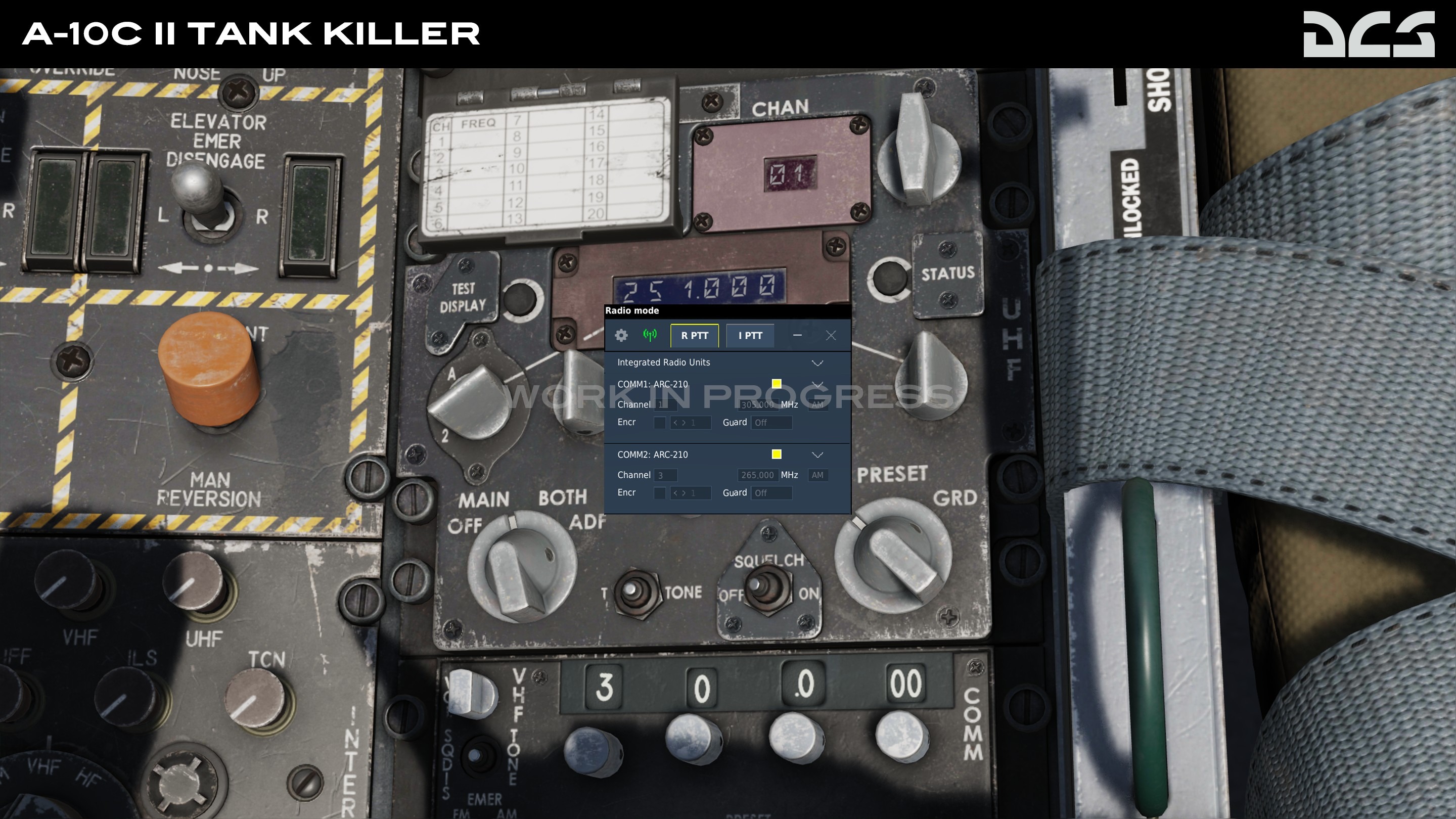

Voice Chat
First introduced in 2019, the free Voice Chat integrated into DCS allows Voice Over IP communications based on chat rooms and how you have your aircraft radios configured. 2022 was focused on improving radio communications and stable connections, even over a VPN. In 2023 we continue to develop this feature with realistic radio sounds, effects and plug-and-play audio device compatibility.
Re: DCS --> Voice Chat (VC)
Messaggio da Phant » 29 aprile 2023, 0:07
Voice Chat Development Progress
We continue to work on enhancing our integrated Voice Chat feature to offer the most convenient and realistic audio experience for multiplayer missions, which is crucial for coordinating strategies and executing complex tactics. We are certain that our voice chat will also add to the general sense of immersion and we are determined to see this feature work straight out of the box, without any additional programs or tuning required.
We have improved the overall stability of the voice chat connection between users, even when using a VPN. We are now working on realistic radio sound effects and the possibility for players to create their own radio sound effect profiles. We’ve added static noises for better immersion and a microphone normalization feature with an updated mic test option. Many bugs have also been resolved when talking over the radio between different aircraft modules.
We have also added the ability to mute individual players and adjust the volume of specific channels. This gives players greater control over their communication and reduces potential radio distractions during gameplay.
The improvements to the integrated DCS World Voice Chat system are significant, and it will greatly enhance the overall experience. We are pleased to let you know that these enhancements are in final testing and that they will be released soon.

Voice Chat Improvement
To ensure improved immersion, our new Voice Chat system now uses real-world audio physics to modulate the sound of your voice in order to replicate radio effects. To create more life-like communications, distortions, signal loss, and interference are simulated. These effects will vary based on the era of the radio, meaning, voices in modern aircraft will be clearer than in warbirds.
We are also making improvements to the radio and Voice Chat Room interfaces, allowing you to find your friends in multiplayer more easily.
Soon, Voice Chat will be rolled out to all other DCS modules, starting with the ‘Airboss’ for DCS: Supercarrier. We are also working on a separate voice chat program, which will allow you to communicate with units in multiplayer servers without having to actually run the simulator. Please subscribe to the newsletter in the Personal section on our website for more details coming soon!
